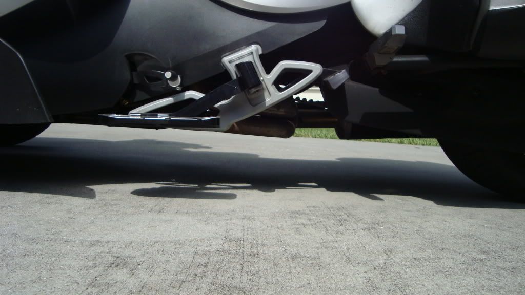

This week I received and added the SBF Racing Floorboards to my Spyder. I contacted them and asked for them in all black. They look great on my Phantom Spyder and installation was pretty straight forward. I did have one issue with the right side floorboard- the bolt that goes through the bottom of the driver peg and into the floorboard shaft seems to be drilled too close to the mount on the Spyder and will not go in. It seems secure without it but I'm sure its there for a reason.
I did a few rides with them installed and here is my feedback. The new driver pegs you end up having after these are on are a bit higher. I had become accustom to the old position with the factory setup. Getting my boot under the shift peg is a bit awkward and will take some getting used to. There is enough space for me, its just different. I could see someone with a larger boot having and issue though.
The braking side is no problem. I like the peg positioning and had zero issue adapting to the slightly different height of the peg on this side.
I like the position of the boards. When cruising I drop me feet off the pegs onto the floorboards for a nice relaxed leg position. Its not the stretch I would imagine with add on pegs or floorboards further up front using other solutions. Perfect for me.
I may add non-skid tape strips to the floorboards. Not for any specific function other than to dull up the gloss finish (I have a Phantom after all!).
I'm contacting SBF about the right side bold issue and will share any feedback I get from them. Overall, a good investment of $400.:2thumbs:

I did hear back from SBF Racing on the "problem" I had with the right side floorboard bolt. It seems I am my father's son- I did not clearly read the instructions which would have told me to insert the bolt -before- mounting the floorboards on the peg mount.
I'm traveling and have not tried to do it the right way but am sure this will do the trick.:joke:
