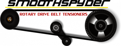

I know where my belt has been, but here is a pic of mine. It has spots.

After adjusting, it appears that the bracket actually has to be tweaked for the roller to sit squarely on the belt. I shouldn't have to tweak the bracket, but I have taken over this thread and I apologize.
We are talking about two deferent issues!!!:thumbup:
