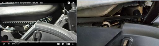

I just installed Tensioner (Doc Humphreys+219800412 IDLER BELT KIT) following the video provided by Doc Humphrey.
Looking at the finished job it looks like I could directly attach Idler belt kit to the frame. This would bring the Tensioner ball about 2.75 inches towards the left where the white take is and it would still give me about 1.5 inched clearance from the bottom of the gas tank and therefore put little bit more tension on the belt. I also noticed the idler where the ball touches the belt the back part only has less than 1/4 inches gap (where the arrow is pointing). The ball perfectly in the center of the belt.
Has any done this or tough about it?
Thanks for your input.

The closer you move that to the front pulley the more vibration will return and if you do that I would suggest doing a clearance test to make sure it will clear the tank in a rear shock failure. I believe from my tests that if the rear shock failed it would get into the tank. I don't recommend using it without the adapter at all.
Here is the failure test:
Lamont, if this is a no-no, please delete and accept my apologies, but I thought it important from a safety factor.
Thanks Doc Humphreys, I am no expert in this matter.
Currently it is installed per your video. I was just curious if anyone thought of moving it forward.

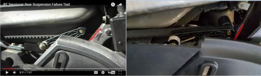

I am not sure what year is your RT, mine is 2016 and when I compare yours with mine it looks like the idler on yours is closer to the tank and away from that support (marked red) than mine is.
I see by the pictures your idler is mounted wrong. The idler needs to be under the piece that Doc made and not on the top. This will change the tension and distance.
David
David
Good catch, Warlock. I missed that. The reason it is placed under is to put it in the same position it would be in without the adaptor, height-wise.
