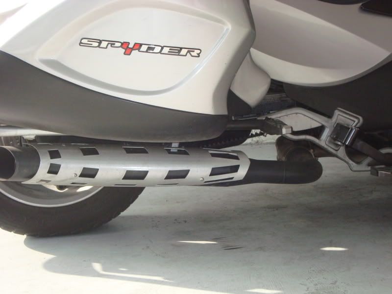

OH WELL Guess I still like it. Especially the sound. Don't think you gonna get any closer to a hot rod Harley Davidson sound than these Spyders do with an after market exhaust. That I LOVE :2thumbs:
