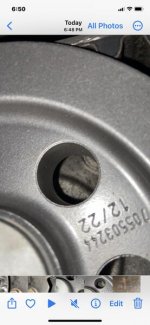

Has anybody had a look and noted or taken a photo of the the part number of the new replacement sprocket?
Or can anybody have a look and advise the part number on their repaired F3? Mine is a 2017.
The number is cast into the LHS face beside the mounting bolt.

I had my front sprocket replaced back in May 2023 , mine is a 17 RTL, this is what was put on
