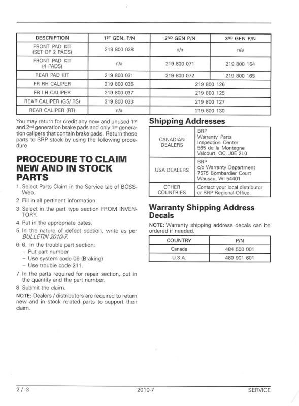

The brake squeal is common. Use the brakes hard several times from 45-50 mph, letting them cool between stops, and it may go away. Clean brake disks help. There are a couple of service bulletins that address this (and now 3rd generation brake pads), but you may have to pay for the cure.
:clap:
After 13000 miles of on and off squealing, and trying all kinds of temporary fixes:gaah:
I went with the 3 Gen. brakes, so far 650 MILES and all is quiet:pray:
