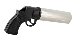

Do you carry a Fire Extinguisher ? :gaah:
Yes, DryShot Hand Gun Fire Extinguisher:

I like that Dryshot; do you need a permit to carry that concealed? :roflblack:
