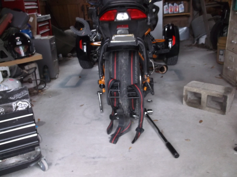

This is how I tighten the rear axle. The adjusters are never moved when the axle is pulled. I tighten the straps on both sides of the rear tire, front of straps over the cross member with lower shock/spring mount. Once the entire assembly is pulled forward so it is once again up against the adjusters, then tighten the axle before removing the straps. The axle will go right back to the exact same adjustment it held before removing it. All you have to do is check the belt tension and the belt tracking on the pulley. If it was correct when you pulled the axle, it should still be correct after you re-tighten the axle. You don't need to bump anything around or pry on anything. Just use the strap tension to pull the assembly back up against the adjusters. You don't need real large straps. Those are just the ones I had handy.
Can't see the pics! It looks like the remote images you tried to load are too large Gwolf :sour:
Maybe when you're posting a reply, you could scroll down a bit past the text field & try using 'Manage Attachments' to upload the image files instead of trying to attach/insert them?!? :dontknow:
Sorry about that, Peter. The images are on my server space under my personal Domain. Most of the forums prefer remote links to save their server space. I sometimes forget that people use cell phones to surf the net, I use a laptop.
The pics should be smaller on my original post now. I uploaded them as attachments.
