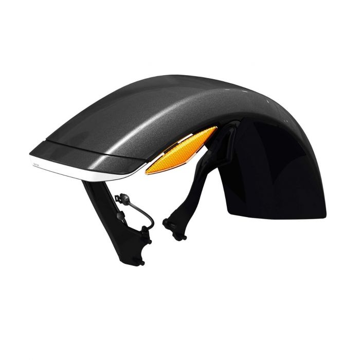

What I don't understand is how the fender can be lifted at all. This is the image from the shop manual. At the base of the fender strut, the bolts are horizontal, not vertical. So no washer is going to raise anything.
The struts connect to a sort of metal band that screws into the fender. So washers there don't seem to do anything either because the "band" isn't going to move any higher, so the fender also isn't moving higher.

When you add washers/shims to the fenders you're not LIFTING the fender at all, Two; you're spacing it away from the tire SIDEWAYS, ie. moving the fender closer to the body of the Spyder and away from the sidewall of the tire, which is where most if not all of the rubbing people generally discover is found.
Some of the tire sizes people fit might need the outside edge of the fender to be gently lifted a touch in order to slide the tire into the space underneath it (like those I'm running! ;) ) but generally, if a tire really 'doesn't fit' UNDER the fender, then you aren't going to be able to move your Spyder at all without the tire tread rubbing on the entire length of at least the fender lip & the ends, if not the entire length of the inside curve of the fender too!! But if the tire juuust touches somewhere WHILE you're riding, so you occasionally hear it rubbing while cornering etc, then it's most likely going to be rubbing on either the inner guard/skirt part of the fender; the struts that support the fender; the fender light wiring that's run up one of the struts; or maybe the raised heads of the hex screws that hold the fender onto the struts are juuust touching the inner edge of the tread cos they protrude down into the wheel well too far! ;)
These can all usually be fixed fairly easily by using one or more of the methods mentioned already in this thread - by doing things like running the right (lower) tire pressures so that the body of the tire doesn't deform during cornering so much up where the fender inner guard/skirt is; by adding those washers to space the fender sideways away from the sidewalls (I only know of a couple of Spyder owners who simply removed those inner skirts entirely instead! :shocked: ); by tucking the wiring away from the tire instead of leaving it exposed to being touched by the sidewall; or by fitting flatter 'low rise' pan head screws (readily sourced from most auto-body stores or fastener suppliers) that don't protrude into the wheel's space instead of the OEM hex head screws that protrude about 10mm's into the space the tire runs in! :thumbup:
So if you're hearing OCCASIONAL rubbing, especially if it's only during cornering, then you're not likely to need to LIFT the fender up away from the tire tread, you're far more likely to need to space the fender AWAY from the sidewall to address the rubbing on the sidewalls &/or maybe look at your tire pressures. But if you jack each side up in turn and take the wheel so you can look inside/behind and see WHERE it's actually touching/rubbing, then if you've ever heard it rubbing, wherever it's been touching should be pretty obvious - while you're in there looking, check out the tops of those hex head screws to see if you also need to swap out those screws with their raised heads, and you might want to take the time to have a look at how thick your brake pads are as well! Never hurts to check around in there while you've got easy access!! :ohyea:

See those four bolts labelled NEW in the pic you posted up in your post #26?? Just put a washer or two under EACH of those, making sure that you put them on the MOUNTING side of the strut base so that they actually DO 'move the fenders closer to the body', and don't just put them under the heads of your (NEW & possibly longer?? ;) ) bolts the first time around! Altho I do know people who live by the saying "We do things Nice, cos we always do them Twice!" :thumbup:
And ... Those M8 fender strut bolts are TIGHT ! They use a LOT of yellow loctite on those bolts. My best tip? Loosen/tighten/loosen/tighten/loosen to break off some of the yellow loctite. Have all four (per fender) bolts loosened up but not off. Put on a couple M8 stainless washers per bolt, one bolt at a time. This will help keep your fender struts aligned, and lessen chance of cross threading. On my S2S, I'll also likely run the bolts thru a M8 die to clean them up before reinstall.
