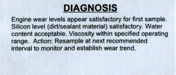

Just got the lab results back for the oil I changed out a couple of weeks ago. They give me the green checkmark! :thumbup:
The oil I use is Amsoil 10w-40 Metric Motorcycle oil. I ran this oil for 10,719 miles with about 2/3 quart added at something like 8000 miles. I made one goof in the sample gathering. It wasn't until I had drained the oil and collected the sample that I saw the note on the submittal form that said to draw the sample within 30 minutes of shutting down the engine. I caught the oil as it was draining from the clutch cover drain, but I had not run the engine at all since putting the bike to bed last fall. I included a note about this on the submittal but the lab report makes no mention of this so I'm guessing not running the engine just before collecting the sample did not have a material effect on the results.

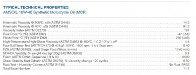

Much of the discussion here centers on the viscosity of the oil after a few thousand miles. It's interesting to note the lab reports the viscosity of my sample as 13.0 cST @ 100C. Compare that to the Amsoil tech data below where they list the new oil viscosity as 14.2 cST @ 100C.
Enlarged copy of diagnosis section.
Amsoil tech spec
Let the comments begin!! :yes:

Based upon the report: are you happy enough to continue using this oil?
I have exclusively used Amsoil in my car, pickup, bike, and ATV since 2005 and will continue to do so. I do use a cheaper oil in my lawn mower! :D

No matter how many times you have your oil tested and post the results, somebody here will disagree with you. I've done the same as you and had both BRP oil and Amsoil tested. I've received the same results as you did with Amsoil and I'm sticking with Amsoil for the 9300 mi. recommended oil change. I think oil is the most hashed out subject on this site. Thanks for your test results.

I for one think that Amsoil is the best oil out there. I used, and sold it for years without any problems. But, they do not have an oil in the grade specified by BRP. It's not only me. The three dealers near me will only use the spec'd oil. They will use another oil if a bring it in. Bel-Ray, Spectro, and Shell make an oil in the range specified. I use the BRP oil and filter and change it once a year. :thumbup: Tom :spyder:
