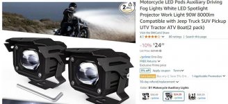

I just added some driving lights to our Spyder. Was not sure how I wanted to do it so checked out some forums. I decided to go with mounting them on the upper A Arm. I have been noticing more and more bikes around here running amber lights in like the fog light area. Like HD aux lights and the ADV bikes on forks. The kit I got however was only white, but they are bright as heck. To my surprise the kit came with everything needed, although nowhere in the description did I see any reference to that. For $25 I didn't think it was a huge gamble even if I had to buy brackets and a switch.
Light kit-Amazon - https://www.amazon.com/dp/B0BTDD5PKM?ref=ppx_yo2ov_dt_b_product_details&th=1 - $25

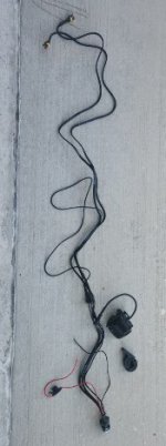

I used the power port on the left side under the "customer" panel. The harness is supplied with an inline fuse. All wires are nicely covered in a plastic tube and ends come with what looks like same type connectors as some of the BRP add-ons.
