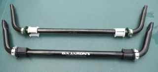

I realized the writing is upside down. With it mounted the other way, the decal doesn't show at all. I looked at it carefully and saw no difference. It seemed to not have any bends that would preclude putting it on "upside down".

There isn't any 'Right Side Up' on the bar. It is symetrical and can be mounted either way.
I realize that the decal will either be upside down, or not visible when mounted. Maybe I should attach them differently. But really, very few people are going to crawl up under a Spyder to see that sticker.
Nice sticker though. A shame to hide it away. I get these from Pete Ameno at PowerSportsWraps (a sponser here at Spyderlovers). Very high quality products and highly recommended for anything graphic that you want to stick to something. They are tough and don't fade like most. I really like that.

This is the RS sway bar. The RT bar is very similar. The Sway Bar is not a shock, it's a straight spring or torsion bar. Doesn't look like much does it. But this little bar can do great things for your Spyder.
You don't have to tear your Spyder down like this to install the Sway Bar.

"Yes... here's a couple of hints.... BajaRon's new swaybar is exactly the same shape as the BRP oem bar, but it is a much larger diameter and therefore a much stiffer bar. By comparison, the Evolucione bar used on some earlier RTs was exactly the same diameter as oem but moved the connection holes at the end of the bar in an attempt to achieve a stiffer bar. If I had an Evo bar installed on an RT I would replace it immediately with Ron's new bar! Been there, Done That!"
but, if you live in the flatlands or hardly ever ride the twisties, you may never notice the difference. The new bar will be more noticeable in very aggressive riding.
