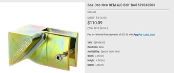

Well, that about reading the manual didn't help much. The manual says to use some kind of sonic Belt Tension Meter P/N 529 036 115.
When I looked up this magical device it costs over a hundred dollars as opposed to the krikit at about $25. Not only that, but BRP has none in stock and no date for back orders.
Sonic Tool
I put the zip code in to check local availability. My zip code according to their website says I am in some little town 50 or 60 miles away and my local dealer is another 50 miles up into Valdosta, Georgia, which is all wrong. It doesn't matter anyway, because they don't have the tool either.
Just another wild goose chase. I got a krikit in the toolbox. The manual is useless if you can't get the tool to do it like manual says.
