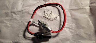

I bought a new switch and spring yesterday. My 2020RTL will be on the recall list, but I'm not wanting to wait, and I'll install it myself. I already had a switch fail last year, but that replacement switch was not the same as this new one. Depending on your model year and vin number you may need to just have the spring added; or need the switch and spring. This is an additional spring where there is not one now. It's actually very weak; not sure what's its going to do. If your bike only needs the spring, it should only take a few minutes. If you need the switch, plan on the 2 hours. The switch can be accessed from below, but they tie-wrapped the wiring up behind the lower sidewall panel. That has to be removed to cut the tie-wrap and reach the connector. These are made in Poland, by the way. Perhaps that explains the shipping delays. See part number in photo below.

How much tension does that new spring have.
I wish BRP offered an explanation as to how that spring helps keep the brake light from staying on.
The new additional spring is about a 2 or 3 pound pull. It's hard to visualize without seeing it in front of you, but when you step on the brakes, the original spring (the one on the left in my photos) pulls the switch plunger rearward. This additional spring is then compressed and assists the switch in relaxing when you release the brakes. If you look close you'll see that the switch has 4 wires. It is actually 2 switches in one housing. One set of contacts will turn on the brake lighting circuit, and the other set of contacts reports to the CANBUS that you have stepped on the brake. The system monitors this action. If you actuate the brake lights, the system is looking to see 500 psi of brake pressure build up in a certain amount of time. If you do not build that pressure or more after a set amount of time, the system will decide that you have a brake fault and will trigger Limp Home Mode. That is why Spyders are very unforgiving of people riding with their foot on the brake pedal. Apparently, this is also the reason for the recall. If the switch doesn't relax all the way, your brake lights will be on and yet you are not building brake pressure, yet you the driver have no way of knowing that this is what is happening. Limp Home Mode can cause a rapid slow down that "could" lead to a crash.
