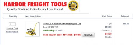

NOTE: I'm using a cheap Harbor Freight ATV/ motorcycle jack lift. Lyonsden has a coupon code to save $40 on this jack. It cost me only $60 delivered.

Thanks for the heads up on the coupon :thumbup:. I just ordered one and used the coupon also!! Thanks!!:clap: :clap:
Great How To, & Thanks for share'n
:thumbup:Teddy made me get the same exact lift from Harbor Freight last year:thumbup:
:shocked:sadly tho, at FULL PRI$E :sour:
