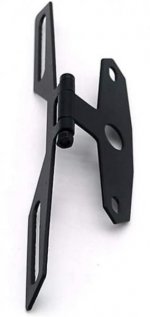

I am liking my Can Am more and more. (It definitely takes some getting used to coming from 2 wheels.) As a side note, my wife just got her license (never driven a bike before) and took to it easily. One of the things I have found difficult is backing up. Well, not the backing up part, that is a piece of cake - it is hanging on the the handlebars and turning around far enough to see all the things in my garage I don't want to hit.
I am so used to the backup camera in a car, I'm pretty sure if I had to back a car up without one, I would just stare at the dash paralyzed, lol.
I had already installed a Garmin Nuvi XT (which is awesome) and discovered that a backup camera is available for it (the BC 40).
I purchased a license plate frame on eBay and used automotive 3M mounting tape to mount it under my Thinkware rear camera:
The Garmin now has a small transparent icon that I can select to show a very clear video image of what is behind me
30 minutes to install.
