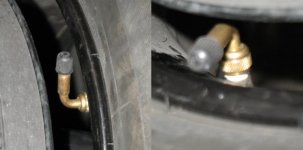

I also have 90 / 87 degree stems .... however I didn't use the OEM hole .... I drilled new holes on the disc side of the wheel where it's flat ..... I'd love to see a pic of the 90 stem in the OEM hole ..... which way is that stem pointed ???? .... Mike :thumbup:
I was going to add a better set of pictures to my previous post, but the page said I didn't have permission to do that. So, here is a collage of two shots. One from sort of behind and above as you might see as you approach from behind to check pressure. The other from almost directly above the stem. There is about a half inch clearance between the stem and the drive pulley. I've had it this way for about 3.5 years and 7500 miles. It loses maybe 1 or 2psi per month mostly in the winter, so pretty similar to all of my cars and bikes.

:thumbup: Since the sprocket and wheel rotate as an assembly, if it doesn't touch it never will ......that pic gives a better perspective :clap:..... Mike :thumbup:
