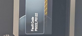

I may have to unplug it. Never changed settings on the move. It's been on the same setting since I set it up (according to the instructions). It's the new bluetooth model so I'm curious if that is causing it to throw up those codes. Not sure at this point. Frustrating when it happens though.
Have you tried pulling the code or putting your Spyder on BUDS? Something that would give some direction. Have you tried running with the PedalBox disconnected? We've install these in quite a few bikes with zero issues.
