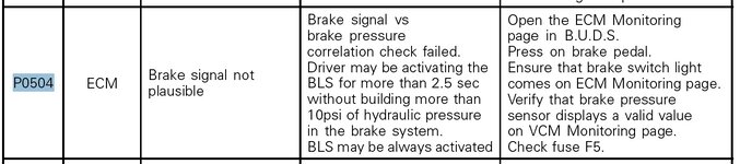

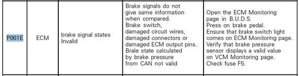

I rode it about 15 miles and stopped and restarted it about 3 times. Oil level is full. Shows to codes and both are brake related. I really don't understand that.

Update; I just looked up those codes and they are for the brake light switch, did you bump into the switch or the wiring for the brake switch while changing it out ? It is near that cover.
Also , I just recently found while doing my winter maintenance that the nut had fallen off my brake linkage and the only thing holding the linkage together was the safety retainer. Visually inspect your brake linkage and switch .

It does. Your brake signal from your brake light switch is implausible when compared to the actual brake pressure sensed in the system. So, it’s either a signal that your brakes are on, with no pressure - as though you're riding the brake pedal slightly - or you have brake pressure with no signal from your brake light switch. Any possibility that you tweaked on your brake pedal linkage while you were doing all this maintenance? Jacking it up? Removing that clutch cover plug? Brake light switch spring? Do your brake lights work? Are they stuck on? Have you had your Brake Light Switch RECALL done? You get the idea.
