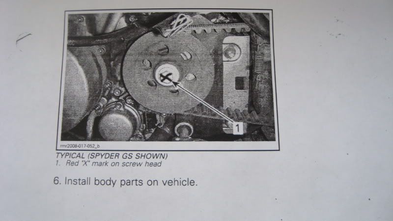

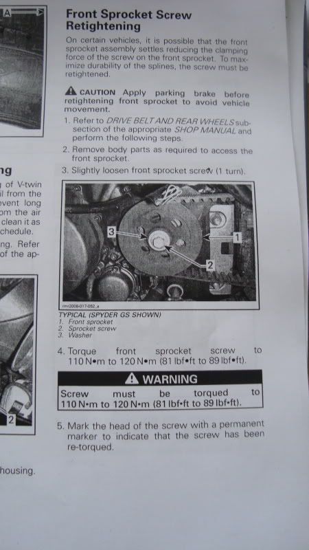

My typo. Belt tension SB is 2010-6. Thanks Doc for posting photo of SB 2010-1 on bolt torque. Dealer still desn't know why they can't find it, but your photo worked. BossWeb must not be as user friendly as SpyderLovers. :2thumbs:
Thanks for posting that Doc. It should be a big help if the dealer I am going to tomorrow cannot find it as well. :2thumbs:
