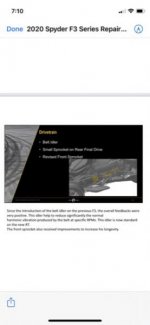

Look at last sentence....from 2020 F3 &RT updates
