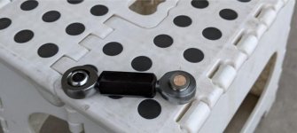

Or put a dowel or piece on hose in the end and push it out with the bolt.
