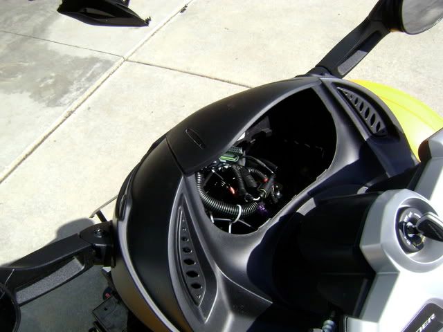

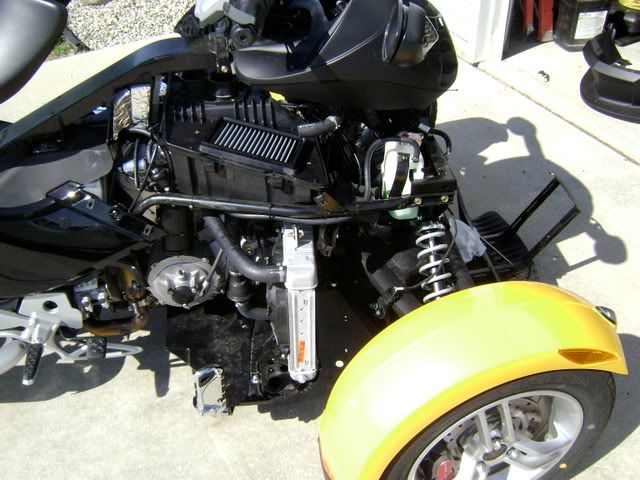

I got my Evolution II installed this morning. Well, actually I got it installed this afternoon. I started it in the morning but I had one of the windscreen screws, with a flat washer and a rubber washer on it, fall off the dash, go through the steering column hole and land somewhere in the innards of the Spyder. Just looking for the screw through the steering column hole and through various holes, nooks, etc. at other points on the Spyder yielded no results so I started removing panels, one at a time, and continued the search. The longer I looked and surmised where it could have bounced to, lodged, fell into, rolled down, etc. the more determined I got to find that screw.

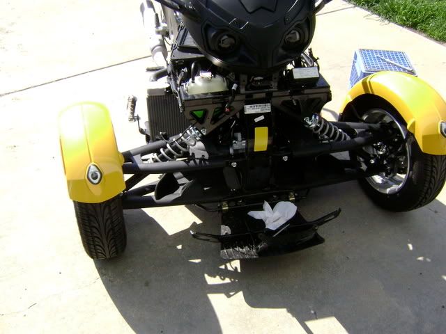

**** WARNING ****
If you are installing your new Evolution II windscreen and your Spyder looks like this, something has probably gone very wrong.

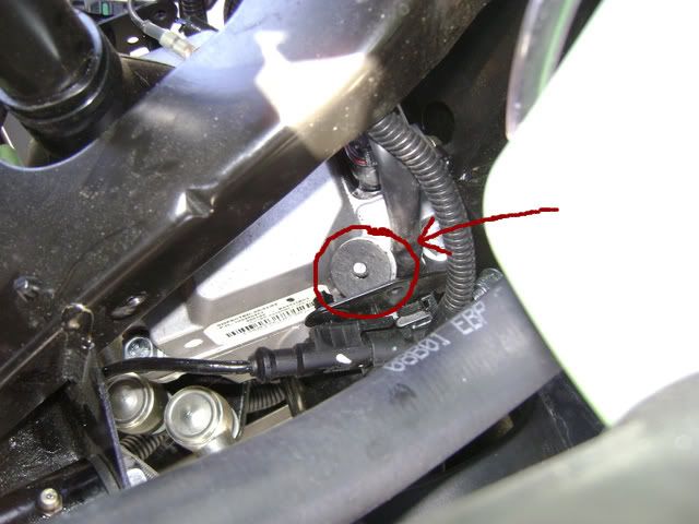

Now I really wanted to post this whole experience on here and get around to the point where I say, "and it was in the last place I looked." but that wasn't to be. The missing screw whooped me. I figured the Spyder must have ate it or one of lamonster's coons slipped into my garage and made off with it. I resigned myself to putting the Spyder back together, putting on the stock windscreen with three screws and going to the hardware store to buy another screw. So I started slowly putting all the stuff I took off back on, hoping I got all the screws, clips, sensors and wiring that I removed back in the right places. After I put each panel back on, I gave one more quick check for the screw in each area. What can I say? Persistence pays off. I found the little bugger lodged between some module and the frame.
It looks pretty noticeable in the picture but I had pulled it up a little by the time I took the picture. It was down a little deeper, the flat washer was not visible at all and the screw was at the perfect angle so when I looked at it, all I saw was the dark rubber washer that blended in with its surroundings.

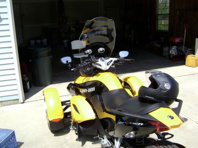

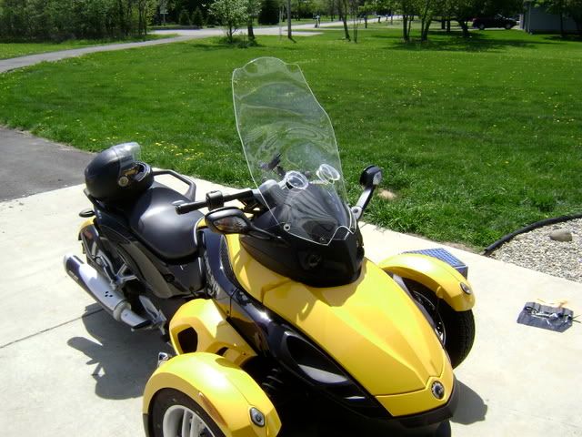

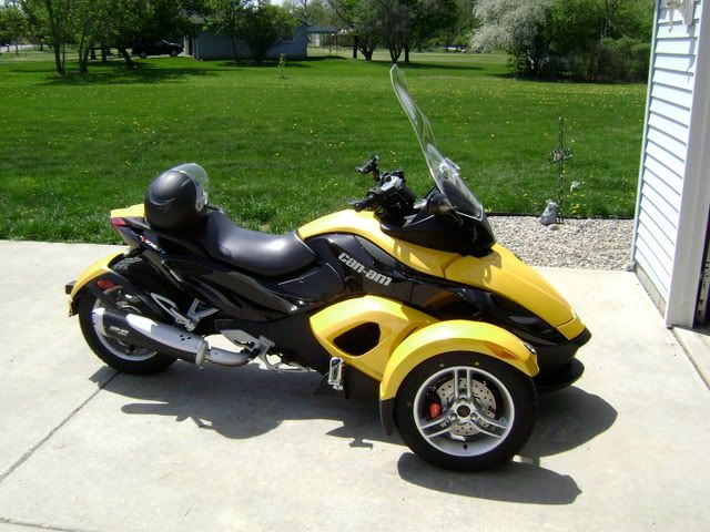

So, after my three hour Evolution II install, my Spyder looks like this.

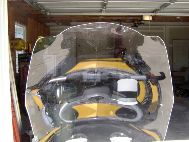

And this is my view, eye level, from seated on the spyder. In my normal seated position, I am looking through the top third of the Evo II. BTW, I'm 6'4" tall. If I was 6'7" or so, I would be looking over the top of the Evo II.
I'm not geeked about the looks but I bought it strictly for higher speed riding comfort on long trips. I took it for a test ride and it performed wonderfully. I constantly caught myself going 20 MPH over the speed limit as I was used to getting the "wind in my chest" speed feedback to help gauge my speed. With this shield, I had no wind in my chest, in my face or on my helmet. I sat as tall as I could to look over the Evo II and still had no wind buffeting my helmet. What I did notice was a bit of air pressure on my back, pushing me forward, as my speed got up around 50 or 60 MPH. The back pressure increased as my speed increased. I'm not sure if Marcel's recommended tweaking of the upper lip of the screen would change or eliminate this effect. It's not too bad and I think I might get used to it after a while but it is there, and it is a little discombobulating at first. I will say, it is much, much better than the buffeting the front of my body took when riding at highway speeds with the stock windscreen.
After riding around town with it this evening, I appreciate how smooth it makes the ride feel in comparison to how it felt riding with the stock windscreen. It is quieter too and I can ride in complete comfort with my face shield up and no bugs or debris hit my face.
