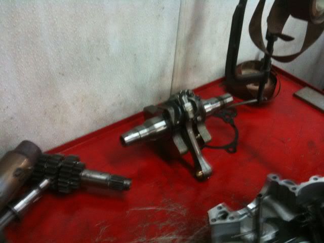

Brian and I went up to Nord Ride (our dealer) to check on the progress of our spyders. Some of the necessary parts needed have arrived and they are actively working on my spyder. In the process of getting into the "guts" and the underbelly of my spyder, Roger, the service manager took some photos to send to BRP. He is just checking on the wear of some of the parts to determine if any replacement should be done or not. Brian would know more about this than I. I really didn't understand anything that was being said. I did take some photos of the spyder guts all laid out that I will share.

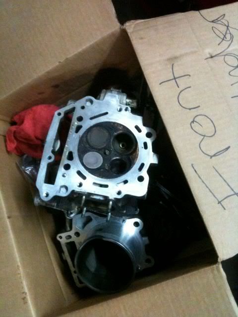

There was a strange looking piece of metal stuck to the magnet on the oil drain plug. BRP authorized an extensive tear down to look for something broken that the tiny piece of metal might have came from. They couldn't find anything broken or identify what piece the metal may have been a part of.

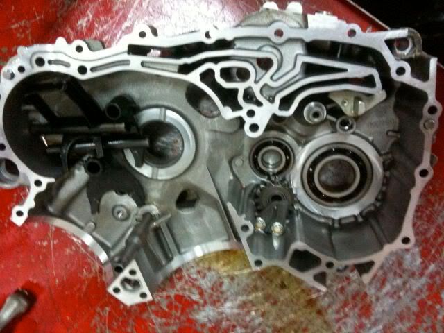

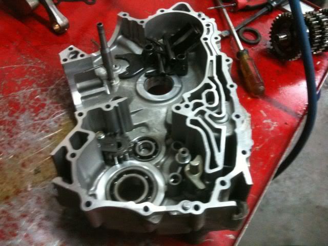

Here are the pics that I took of the Rotax innards.

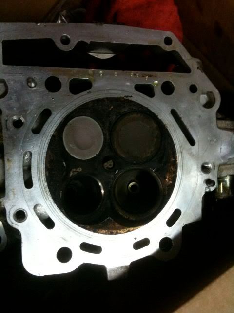

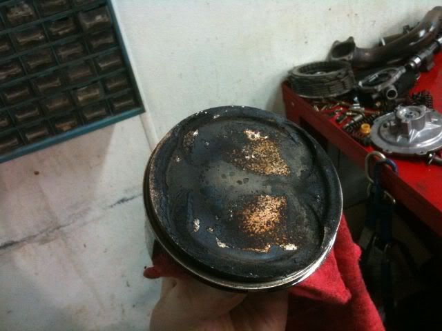

The service manager questioned the appearance of the intake valve seat and sent some pics off to BRP to see if they felt it was okay / normal or if they wanted him to do something about it. I'm not a motor rebuild guy so even though he was pointing out what he was questioning, I couldn't tell the difference between what he said was normal and what he said looked different. I'm sure my photos aren't good enough resolution or lighting for anyone else to tell just by looking at these.

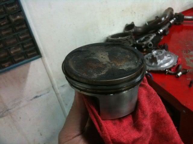

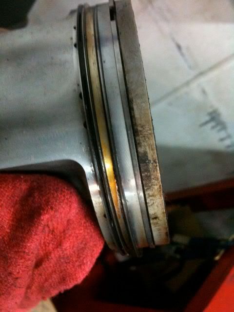

I only looked in the box that was marked front cylinder and I pulled out the piston from the box just to see what it looked like.

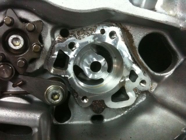

Another thing he questioned was the wear in the oil pump area. He took some pics of that and sent them off to BRP also. I see in my photo (below) you can't really make out the wear marks that he was concerned about but those were visible to me when he pointed them out (upper left side of hole).

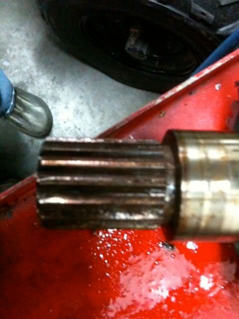

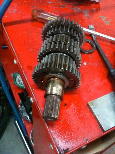

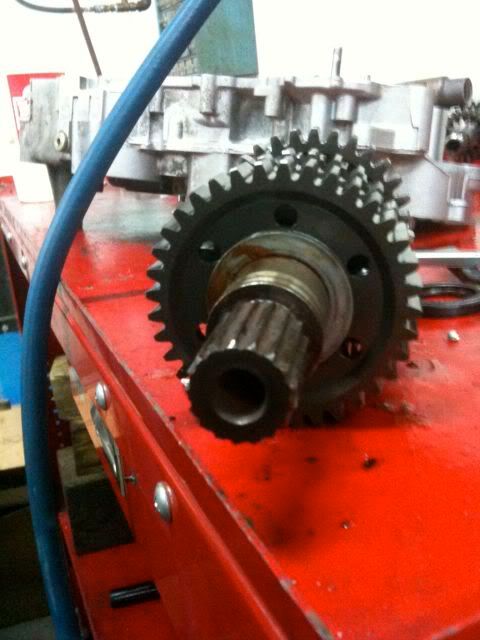

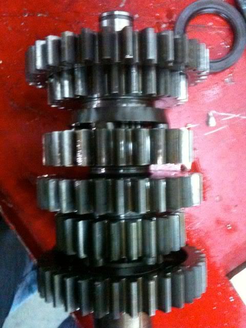

Gears and the output shaft. The output shaft splines certainly didn't look right though there weren't any chunks broken off. He reiterated that he feels it's bad metal on the sprocket that is causing this wear. He also said it may be related to the two pieces being on the opposite ends of the tolerances allowed during manufacture that allows excess play in between the two pieces, causing premature wear. He's still waiting to see what BRP thinks may be happening in this case.
