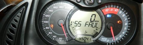

2009 Spyder RS SE5 -- original DPS part failed on interstate and trailered to dealer for replacement of recall unit. Also asked dealer to perform routine service. Bike has 5500 miles only. Left dealership with bike feeling overly nimble on steering (to point of easily oversteering), made it 5 miles down the road and bike didn't "feel right." Rode back to dealer, noticed front right tire might be a little low. Got there, they added just a smidge of air to tire. 25 miles later, in route back home, DPS Fault message came on dash, along with Limp Home Mode, indicator light (left side of dash), and also engine light. Pulled over and called the dealer; told them what was going on and that bike smelled like it was frying, maybe an oil smell. Noticed front right tire looking slick on interior 1/4 of tread --- had not left the dealership like that. To make a long story short, bike now at home and waiting for the dealer to finish with a boat show before they'll even talk to me. DPS Fault message no longer displaying (understandable since bike isn't in motion), but now have a message of "1:55 Fault" ----- would like to know what that stands for. Engine also overheats in under 5 minutes, to near explosion level. WHAT COULD HAVE HAPPENED TO THE BIKE??? In addition to DPS unit changed out, they also installed the electrical ground wire to the shift (another recall) and did the ECM (??) software update. ANYONE WITH INFO OR IDEAS?

In the RS SE5 manual there is no code ending with ..55. Take a picture of the display showing the fault code.
Having no luck uploading a pic to this site. But hearing that there is not a code ending "55," the digital display could be VSS Fault ---- if so the V is slanted to the right and not filled incompletely, which makes it look like "1:55 Fault." Hope that helps. I will continue to try to get the pic uploaded.

This is "VSS Fault" not "1:55". Ask the dealer where you replaced the DPS to repeat the "DPS replacement procedure" conform BRP instructions.

The DPS and VSS errors are likely a result of the DPS installation. Most likely the tech failed to recalibrate the steering sensors properly. The engine temp is probably a different issue. It could have been caused or triggered by the tech when he had things apart or during reassembly, or it could be circumstance, and unrelated. A good shop would apologize, and look at the problem before placing blame. I'd talk to the owner of the dealership, calmly, and explain what happened, that you did nothing to cause the problem, and express your unhappiness with the treatment the service advisor gave you. Hopefully they will take a thorough second look, at their expense, and correct the problem ASAP...in the interest of customer relations if nothing else.

Extract the error code.
My local dealer service appointments are 7-10 business days out. I know how you feel. The forum might have a dealer-free answer with a little more information. By all means this is a dealer problem and you should not repair yourself, but when it comes to VSS & DPS faults, you can never learn enough valuable information.
EXTRACT THE CODE
1) Drive the bike until you have an active code. If overheating is a concern, don't let the temp go too high or get too far from home.
2) Stop and leave the engine running in nuetral.
3) Use the MODE button to select the "Hr" total hour meter.
4) Push the high beam flash button 5 times within two seconds.
5) All active codes will be displayed, one at a time.
6) Record the codes. Myself or other forum members will gladly define the codes for you.
The more you know about the codes when you do take it back to the dealer, less chance they have of talking around the real problem, taking you out of their repair scheduling again and forcing another visit.
Good luck,
Spydersense
