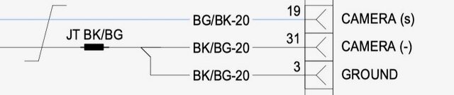

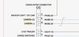

Here is a clip from the maintenance manual of the pinout.
Also, here you can see the Camera (-) eventually goes to ground.
So I connected the cameras - and power - to Camera (-), the cameras power + to Backup Light / 12V Cam , and the cameras signal to Camera (S).
Turned on the Backup Camera in the software and put it in Reverse and the camera image displayed on the screen.
