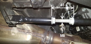

I needed to extended the brake rod by 45mm on my 2017 F3 from where the previous owner had it, and it wasn't hard at all. The tube bore dia. is about 6 dia., so an easy drill-out to tapping size for M8x1.25. I tapped both ends 30 deep with a RH thread & used a 95 length of galvanised threaded bar with hex lock nuts on either end + blue loctite. Doesn't give the fine adjustment that a RH/LH arrangement would, but it avoids needing a special LH/RH threaded bar & you still get an adjustment of 0.63mm every half-turn - more than sufficient.
Never had any buckling issues even on hard emergency stops (I checked this immediately after doing this mod) but if you need to extend it more than that, maybe consider fitting a hex coupling nut over the exposed threaded rod to stiffen it.
Never had any buckling issues even on hard emergency stops (I checked this immediately after doing this mod) but if you need to extend it more than that, maybe consider fitting a hex coupling nut over the exposed threaded rod to stiffen it?!
.View attachment 252404
Love it when people think out of the box!!! Good job!!! The thread coupler is a great idea!!
