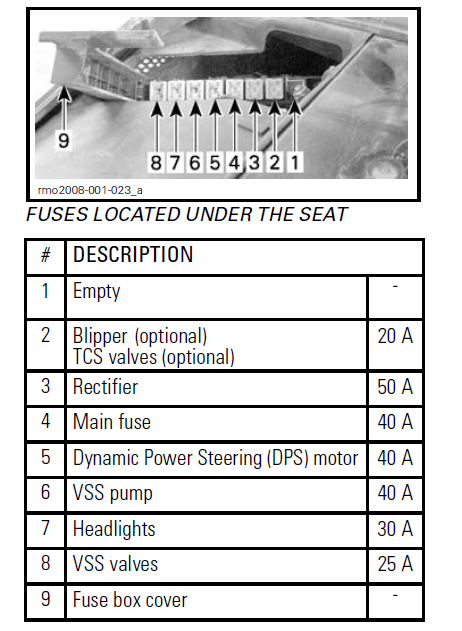

details on fuses under the seat
Hi there.
Not sure if this will help, but here are some details on those 'under the seat' fuses. The most important thing is that your spares will fit and have the same specs are per the rated amps as per the manual.

All should be readily available at the local auto parts store, except the 25 amp fuse, which is an oddball. You have to get that one from your dealer.
Are they low profile?
I found all of them on-line but I don't know if they are the low profile ones....I didn't find the 25 amp though! How much does it cost from the dealer or how much should it cost?
Here is a 25 amp fuse (jcase lo profile); $4.68 and probably not worthwhile unless you plan on buying more than one or other fuses d/t shipping-
