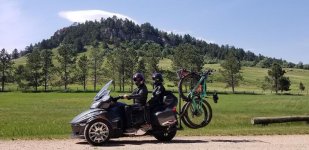

PMK, I have no idea what it feels like to NOT have the hitch on. It has been on since day one. What you say makes good sense regarding cornering forces. Due to the receiver I welded onto the hitch for my bike rack, it will never be removed. I hope this pic comes out. My computer is 20 years old and my brain is....well, significantly older than that.
