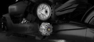

Contemplating modifying primary clutch
SportsterDoc
The primary clutch has the fixed side, next to engine.
A one-way bearing over the shaft for bottom of belt contact during idling, which also permits engine braking (secondary drives primary).
The moveable side (governor cup) has weighted levers to close the clutch (for engagement and for gear ratio) with an over-the-shaft spring with an opposite force to facilitate clutch opening.
I would expect that the spring for the secondary clutch simply maintains pressure on the belt sides, as the effective diameter of the primary changes.
At the sacrifice of acceleration, I am wondering what heavier weights (combined with lighter spring?) are available, to possibly reduce cruising RPMs. I would not expect changing the final drive from 3.15:1 to be an option.
Tslepebull inquired 3-6-19 https://www.spyderlovers.com/forums/showthread.php?119097-Wasted-Power-in-900
I am anticipating some answers to be to the effect that Can-Am has already provided the best balance between acceleration and cruising RPMs (directly related to fuel economy)...and that may be true...but would like to know what options, if any, are available and potential consequences.
There are clutch kits for Can-Am Mavericks, for running larger tires, etc...anything for the Ryker and any performance results?
I would think the aftermarket would be developing different springs, different weights, different angles on the fingers(ramps). Both clutches can be tuned. They have been doing this for more than 50 years in the snomobile industry. Bruce

Need more info and a higher resolution diagram to properly name the parts.

What is it your really trying to get out of this when you done? Lower engagement or more top end, or both? Like a lot of guy's above have said this system has been around a while on sleds, atv's, and clutch kits for those price wise aren't that bad, but it is a trial and area thing on the Ryker I think until enough gear heads like you want to soup up there rides, the aftermarket boys won't gear up and make the packages until they see the market!!:dontknow: I am sure that the clutches in the bike are being used in other app some where, and there are weights and springs to be had, and gearing, you just have to decide weather you want to do the R+D for the aftermarket boy's or ride that thing!! Good Luck, Ride Safe!!
You are looking at replacing the entire clutch with aftermarket with those kits. Another option is to just replace some of the internals of the stock clutch https://www.straightlineperformance...ces-new-0-3000ft-ski-doo-e-drive-clutch-kits/
But clutching might not be the way to achieve what you want? Maybe a gearing change in the gear box is a better move. Again, very simple to to do on a sled......easier access. Harder to do on the Ryker.
There is a trade off though. Maybe you can find a clutching/gearing setup that gives you 2800 RPM at 60 mph but acceleration to 60 mph might be super slow (if the motor power band could even pull it at all)?
No need for more top end.
Stock it is capable of 107+
100 up a slight grade and mild head wind.
If I can hit up to ~95, passing a big rig (beginning the pass at 70) on a two lane, that is more than sufficient.
Not interested in cruising more than 80 (Interstate 15 speed limit in Utah, north of St. George), if engine not wide open.
If lower engagement, then less likely for tire spin off the line, but that is only minor.
The main interest is lowering cruising RPMs.
Not seeing the need for 6700 RPM at 75, when my CB1100 (86 HP) could pull 100 at 5000 RPM.
The trick is finding weighted levers for the Ryker clutch basket.

Those are not specific to the Ryker. Those are specific to the clutch used on the Snowmobile with the 900 Ace Engine. I'm sure if you checked part numbers the clutch on the Sleds/ATV's and the Ryker are pretty much the same so those parts "should" work on a Ryker but of course its a guess and most likely the "kit" they are selling for the sled will not lower the RPM as you are trying to do. I was just pointing out that you don't need to replace the entire clutch and can just replace some components.
My initial interest was changing the centrifugal parts/spring, rather than an entire new primary clutch assembly. I was answering, the "have you researched" question.
