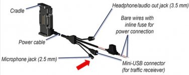

I just installed a Magellan Maestro 4050 on my 2011 RT. I used the Can-am mount and cable ($150) which allowed me to hear the voice instructions from my gps and also hear calls from my Bluetooth cell phone. The gps instructions and cell phone calls mute the radio and come through the speakers. All I had to do is buy a 3.5 extension cord at Radio Shack and plug the male end into my gps's headset socket and the female connects to the Cam-Am's cable. As long as your gps has a headset input and Bluetooth it will work as good as the Garmin Zumo the factory puts on the LTD.

You have to purchase the Can-Am GPS plug, it comes with the mount for $150 but you can buy it alone for $50 because it is an item on the limited model. The dealer will have to look it up in the parts catalog for the limited. The plug has three wires two for the power and one male that looks like a mini male headphone plug. This plug connects to the Can-Am's radio unit. I went to radio shack and bought an head phone extension cord that had a male and a female end. I plug the male into the jack on my Gps used for headphones and female connected up with the male on the Can-Am plug. You can do this with any Gps that has a headphone jack and Bluetooth (For Cell). Now the when the Gps give the instructions it mutes the radio and plays out the radio speakers. If your Gps has Bluetooth for your cell the radio will also mute and you can hear the caller on the radio speakers. You have to use the Gps mike to talk on the cell. This is not perfect at 70mph but acceptable at 50mph. I hope this answers you questions.
Stevedfive, the picture you have is of the Zumo's plug that would plug into the Can-Am's cable I bought. The bike has a plug that mates with the Can-Am's plug located just under the right side upper panel.
