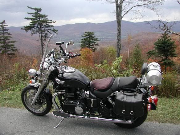

For frequent long trips consider adding a TourTank. Adds two or more gallons capacity and can be plumbed into existing fuel lines. Need a rear rack to mount it.
The TourTank I was thinking of is a two gallon, available with nice looking black nylon cover, looks like an average size small duffel behind the seat or rack. Because I'd move mine from bike to bike, and rarely actually have the time for long trips anyway, I'd probably use it for reserve fuel, and pipe it into the fill neck during a leg-stretching break if a fuel stop wasn't imminent.

If you're installing it higher than the fill neck on the bike, a simple hose to the filler is fine (with a valve, of course), keep it coiled and stowed when not in use. That's the way I'd use mine. The tanks are made to be plumbed into a regular fuel line with a quick disconnect. There are some plumbing extras needed on fuel injected bikes since the fuel lines are pressurized on FI machines. I believe the website details it.

I've had aux fuel cells on my last 3 machines - 2 BMWs and a Triumph Sprint ST. The BMW installs both required electric fuel pumps for the transfer but the install on the Triumph was high enough to enable gravity transer. In all 3 cases I plumbed into the tank 'balance' hose, or FI return hose.
The setup on the Spyder is the simplest! I'm using a 3 gal molded cell, from Summit Racing, so it is 'rated,' The tank sits on a steel tubing rack which can be removed in about 1 minute. My Pelican travel trunk sits forward of the tank. Below the tank is a simple 1/4" ball valve and a line which tucks away under the seat. Not wanting to take the fuel tank out and start making holes in it, I simply 'catheterized' the fuel cap with a short hose and 90 degree brass fitting. Takes a few seconds longer to unscrew it (while holding the fitting still) but it works perfectly!
I typically fill both tanks, and after about 120 miles I know there is room in the main tank for 3 gallons. I reach back and flip the valve and just watch the fuel gauge return to FULL. This takes about 3 minutes. Range is now 260 - 280 miles.

I had that same Tour Tank on my Triumph, nicely spun aluminum, weighs NOTHING when empty. And the included steel bands make for very easy base mounting. Good choice.
