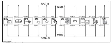

Took a quick look at GS911. To begin with it uses a standard OBD connector. BRP for Spyders and many UTV/ATV models use a Deutsch DB6 connector. The DB6-OBD adapter is easy to build and can be used to read the CANBUS messages. But BRP is using non-standard proprietary OBD PIDs. If you have a BUDS you can monitor the CANBUS traffic and eventually decode the PIDs. But with a 500kbps CANBUS there's traffic is pretty heavy (about 16 message/sec for typical identifier). Here's the analyzer I'm using https://www.amazon.com/Analyzer-CAN-BUS-Intelligent-Converter-Adapter/dp/B07FY4YLPL/
PS the differences between my earlier posts and now are due to loss of ignorance. Turns out the Spyder CANBUS was overrunning my analyzer and I wasn't aware of it.
