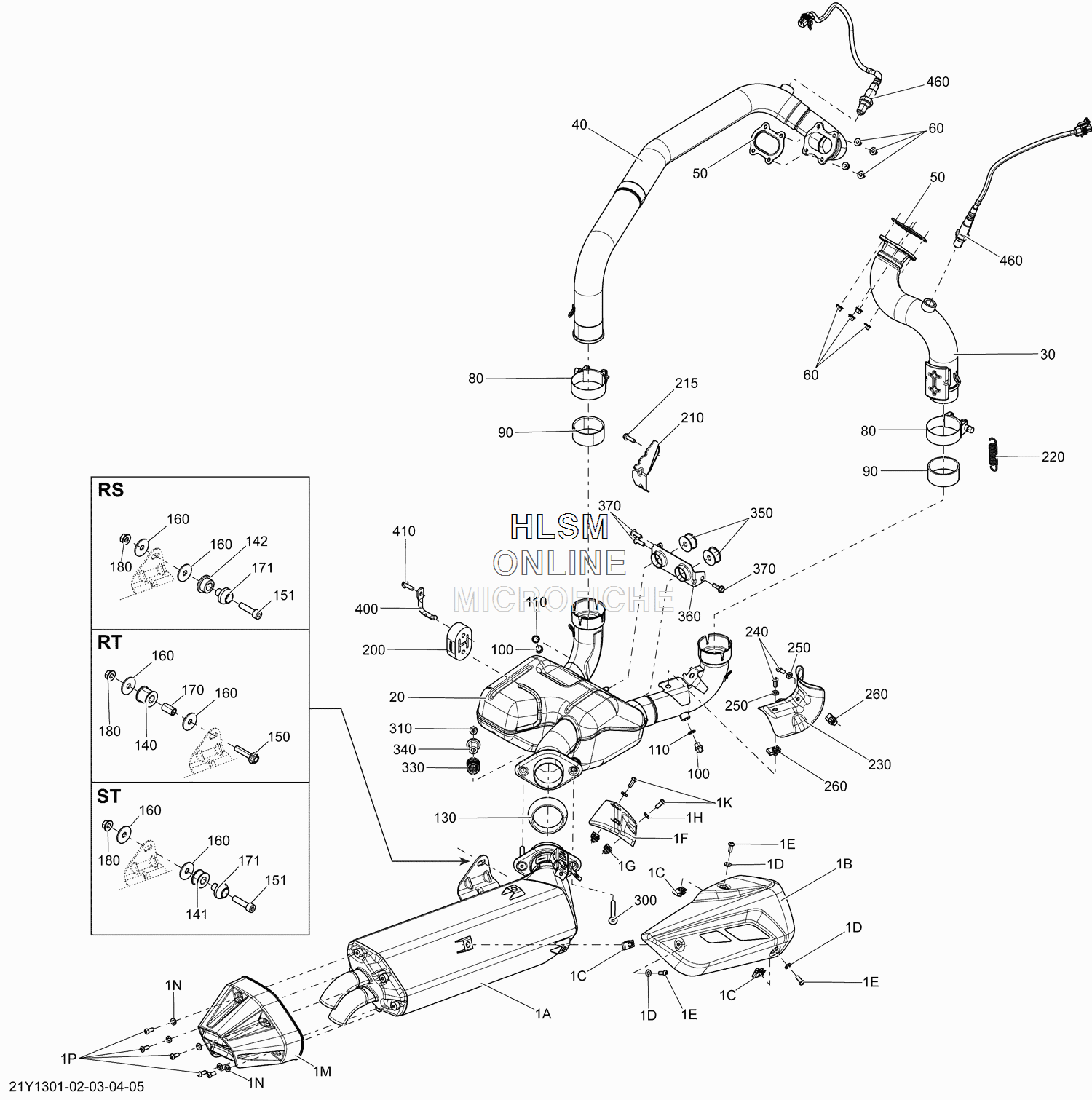

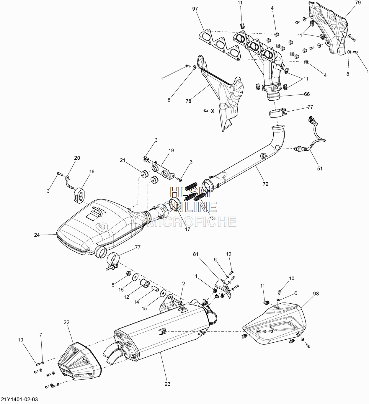

We do not own a 13. This is a copy of the 13 RT exhaust system.
I really doubt the issue is related to the fuel system, the heat is the problem and the fuel system suffers because of the heat.
This is the exhaust on the 14 RT with the 1330 engine. Far lass exhaust system under the bodywork, therefore less heat is trapped.
