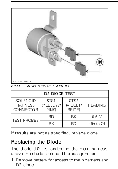

D2 DIODE (STARTER SOLENOID)
D2 Diode Troubleshooting
A defective D2 diode will result in the following
conditions.
Shorted Diode
Fuse F8 will blow continually.
Open Diode
Diode will not provide protection to the sensitive
electronic components. Malfunction or damage
may occur to the ECM.
Replacement is on page 439 of my service manual. May be on a different page of your manual since I have F3-S. Same section has troubleshooting instructions and procedures for testing with a multi-meter. If you are going to attempt the repair you are going to need the manual and a few testing tools.
conditions.
Shorted Diode
Open Diode

That should fix the starter problem. Might be wise to test that D2 diode while you got it open. It should be right by the solenoid. Test procedures are in the manual starter repair section. If the diode is allowing reverse current or two way current it will damage the system.
