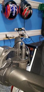

Here is a picture of my battery tender with the cigarette lighter adapter plugged into my Lamonster PowerPlate: tender1.jpg Simply plug it in and you are good to go. Don't have to open the frunk or anything.
I installed this weather proof power plate from Lamonster:
http://www.lamonstergarage.com/search.php?search_query=Power plate&section=product
I wired it straight to the battery. It gives me 5v USB or 12v cigarette outlet to power a phone, gps, radar detector, or whatever. When not riding use the male cigarette plug that comes with some maintainers, to plug the maintainer into your 12v outlet. That way you don’t need to leave the frunk open or the seat up to get to the plug for the maintainer.
