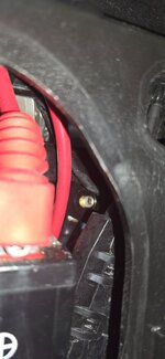

I had the battery compartment open to install a battery tender cable, since the previous owner didn't install one. I opened the liner, removed the battery cover, and popped out the rubber grommet to the right of the battery. I hear there's a 12v accessory connector 'somewhere inside' where the grommet is. I've fished around with my fingers, but found most tubes back there feel solid and metallic, or major wire harnesses. If I look from the tire into that area, there looks to be metal pipes (abs? vacuum?) with screw-in connectors and a large harness from the fuse box? What am I feeling for here? Is the connector pushed into the plastic and needs to be found and then pulled? I hear the side connector is stored that way.
The accessories cable is on the right side, under the panel that goes to the frunk and has 3 screws and 3 pushpins (under the frunk cover)
By the aux light, I’m guessing you mean the bottom one? I guess the previous owner had one installed and removed it. If it was installed by the dealer, maybe he didn’t have that plastic panel? The wire is probably pushed in - in between the bottom of the inner tub. The connector goes out on the left side of the frunk under the same panel as the right side 3 x pushpins/screws.

I have power behind the battery area, nothing at front, but British versions do not have the front auxiliary wires. I used a cheap endoscope to look for them. It's pretty useful for looking in and under the Spyder.

🤦‍♂️ I have a endoscope and I totally forgot about it and didn't even think that direction.
Yeah, it's the bottom light or panel I was referring to, so I'll check to find that wire and if I do, I'll probably fish it out and buy a light, otherwise maybe I can 3d print a blank panel... I suspect buying the OEM blank will cost more than a light. Anyhow, if I do need to make up a blank, I'll post the stl on Thingiverse, should someone else need one.
The light on the BRP site is: can-am on-road kit - auxiliary light - 219400991
I'll pull the side panel off in a few weeks, find that connector and hook it up, now I know there's power there. No rush, for the next few weeks I won't be riding anywhere I don't know..
