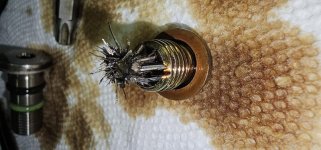

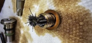

Doing my first oil change on my new to me F3S.
I noticed a significant amount of metal on the clutch drain plug.
It has 10,100 miles, and I don't know exactly when the last oil change was.
The previous owner did say he took it to the dealer for service, and he's only had it for about 5 or 6k miles and 3 years.
I'm not going to worry at this point, but I will keep an eye on the situation.

If you just took that out of your bike, I would say that you have something going on !!!! Think it's more than just an eye job!!! Good luck!

This would not be good even for a 1st oil change. Both the volume and size of the pieces are concerning. It would have been good to supply an oil sample for analysis. I would recommend running for 500 miles and pull the drain plug again. Hopefully, it will look much better. However, if it shows signs of going the same direction, you should pull the clutch cover and find out what is going away before you end up with a much larger issue.
Thanks Ron. I'll definitely do that.
The main reason I didn't collect a sample is that I'm not certain the type of oil, or how many miles it's been in there.
I didn't notice any similar debris in the oil filter. I did keep it, and I'll take a closer look tomorrow.
The clutch operates smoothly, grips well, and I haven't heard any unusual noises from the motor or tranny.
I'll check it again after 500 miles or so, send in a sample for analysis, and let you know what I find.
