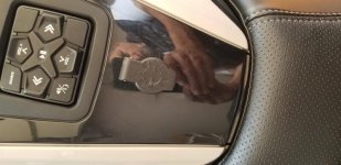

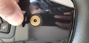

I ride solo and I installed a power port for my heated gear right up front. I also use it for my battery tender.
