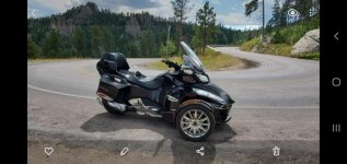

A little story first- I've been on Motorcycles for 52 years. Had 24 bikes, mostly Harleys. Sold the 2014 Road King a yr ago(more or less give away-if you have tried to sell a Harley the laste couple years-Major painfull Price Drop on HD)
I'm a BRP fan as I've had their ski-doo sleds for many years. I began looking at Spyders and liked the idea of many, who said get the 2014 & newer with the 1330cc engine. I started looking late 2019 winter last year, and found the one I wanted- Black with the Limited Chrome pkg. Had to travel about 500 round trip miles to buy it. None around here with the color and Limited pkg.
Got it mid July & drove it then, discovered the lously Kenda front tires. Changed those to Federal Formoza AZ01 & was happy with the increased control. My next add-on would be the famous Baha-Rons sway bar. I ordered after christmas from lamonstergarage.com who provided outstanding service/shipping. Just before Sturgis 2020 I began to install it. After I had the bike lifted up, to my surprise there was one on there already! I'm the 3rd owner. the original owner bought it new had died before he had 500 miles on it. The guy I bought it from put on 4,000+ miles. So it had about 5,045 act miles on it when I got it. Its hard to see the bar location so low and covered where it's mounted. I'm sure the guy I bought it from never knew he had one on. I unpacked the new bar and laid it out in front of the bike. I already had the new one and thought; heck I might as well just put the new one on. When I finally got the old one out I could see right away the "Newer-one" was noticecabily larger and more beefier than the one I took out. Got it put together and took a ride down "Boulder-Canyon" to the hair pin 1st curve & wow what a difference! Not even the same Bike! It made such a major difference. Curves down that canyon were now fun. The bar I took out must have been one of the earlier ones made...so is there a 2nd generation Baharon sway bar. I was very pleased with the difference:thumbup:. Took measurments and shows the new one was 2mm thicker...

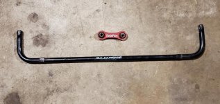

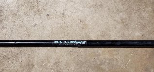

Here are a couple photos of the old bar with red end links. Yes, I'm aware the spyders come with a factory SB. The new bar, measured with my digital gauge showed 2mm larger bar. The new kit had end links with the name "Lamonster"on each one. Regardless, this made a major difference in my spyder...would the newer end links make that much difference...thanks.
It isn't the links. Though the current version is an upgrade over the previous dog-bone style. Rigid is Rigid, the sway bar doesn't care about style. My new links are not better in this department. They are better in that they resist salt, corrosion and rust much better than the dog-bone style pictured. The dog-bones work very well for the great majority of owners. But for those who ride in salt environments, not so good. The new style takes care of that.
The answer here is that you had a genuine, BajaRon, F3 sway bar installed on your RT. The RT bar is approximately 2mm (1/16") larger (diameter) than the F3 bar. I have no idea why someone would do that. There is no savings as they are priced the same. I have my suspicions. But we'll leave it at that.

....The answer here is that you had a genuine, BajaRon, F3 sway bar installed on your RT. The RT bar is approximately 2mm (1/16") larger (diameter) than the F3 bar. I have no idea why someone would do that. There is no savings as they are priced the same.....,
Puzzle solved! Again, it made a major difference...tks.
