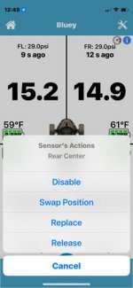

  1. Now start with the Right front sensor & disconnect it from the front tire, your old app will alarm;
  2. Go to the old PROFILE and hold your finger on the box of the Right front tire, you will see a way to release the sensor - RELEASE it, the Alarm will stop;

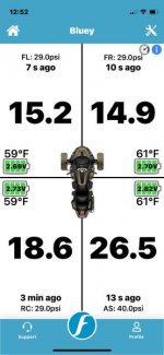

  3. Go to your NEW Profile & put your finger on the box you want the sensor to be on & it will say: Install Right - Skip - Proceed down the bottom;
  4. Proceed and connect the sensor and put your phone to the sensor. You should see the tire pressure in the new profile (it may take a few times for the sensor to install it) - Follow what the app says;
  5. Repeat Steps 1,2,3, and 4 for the Left front tire;
  6. Repeat Steps 1,2,3, and 4 for the Rear tire;
  7. Now just press your finger on the lower right box for the Air Shock on the new profile and add the sensor.
YOU ARE DONE - Make sure to Save after you add the Air shock!!!!!
