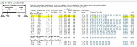

I ordered McMaster Carr PN 9416K11 (30# force) which is a little bit longer than the stock one but not quite as beefy in body and rod diameter.
Installed it today using the OEM "ends" and it seems to work fine
hyea: - holds up the seat with no problem but it is not so forceful that the seat pops up on it's own so I think I have about the right force (30#).

Thanks to K80shooter for finding the source for this strut rod. Might even be able to use one even longer but you are limited to how long it can be based on the travel of the strut and the fixed location of the ball end.
New strut is the smaller one in the pics above. I figured the weak link in the OEM setup is the plastic nib on the seat hinge so going with a slightly smaller shock rod was not going to make any difference - if anything breaks/fails, it will be that plastic nib not a smaller steel shock rod. And, it isn't exactly a critical component.
