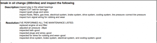

    Hello Everyone,
    So I just got off the phone. The lead mechanic contacted me and explained to me that a full service was completed. Air, Oil, Torque Specs checked and found nothing other than a key post loose inside the air box. She reported the belt and rollers are in good condition along with belt tension. I'll post exactly what their report was below. She believe it was possibly the airbox on the left side, saying these are notorious for vibrations but they could not reproduce it.
    Now the video I sent in text, she informed me on the call that she could not see the video, only hear it, so I provided a link to her via email to my youtube video. She mention the mechanic rode the trike up to 17 MPH with no issues. I strongly recommended her mechanic perform slow speed maneuvers like demonstrated in the video before completing the diagnostic. Reminded her the bike runs great up to speed, but low RPM rolling is when this occurs. Forward, reverse, forward while turning either direction, reverse while turning either direction etc..
    Your thoughts?

    Very Active Member BajaRon's Avatar
    Aug 2007
    Greeneville, TN
    13,730
    Quote Originally Posted by Fludtastic View Post
    Hello Everyone,
    Your thoughts?
    So, according to the dealership, you don't have a problem.
