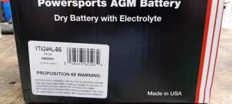

Here's one of the many reasons why I'm glad I hoarded a battery. I got it for almost 1/2 price what they cost now.

That's an excellent point and a smart move. I did the exact same thing with a rear tire. One other reason I did it was the availability issue.
