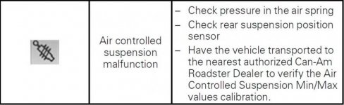

Not sure what you mean by an arrow symbol diagonally down and to the right; is it like this one? Also, what color is the arrow?
That's the arrow. Color is black I think. I do believe the triangle does have the exclamation mark inside. The thing comes on for short of time its had to tell, and its kinda small from sitting in the seat.

Yup, checked the manual several time and that's one symbol they don't show and I find nothing in the book that discusses it so for. I did see in doing research on dash symbols that a yellow or amber triangle with a exclamation mark is a European symbol for a suspension problem of some kinds. :sour:

Okay, I'll bet what you are seeing on occasion is some version of this;Traction control icon.jpg
If so, it is an indication that your traction control system is kicking in. That's why it's only intermittent.

Pages 112 and 113 of your operator's manual show the error icons that can appear on your multifunction gauge but the list does not include the display you are seeing.
They are just the ones that appear in the analog gauges and have a dedicated lamp.
The icon he's getting is in the trip area in the colour gauge on his LTD. The manual says malfunction icons can appear there but doesn't give a list of them.
This is where he's seeing the unknown icon (highlighted area):
Does the operators manual for the LTD (I only have the F3-S one) give any icons that can appear here? The WSM I have covers the 2016 colour gauge but doesn't give any icons for this area.
