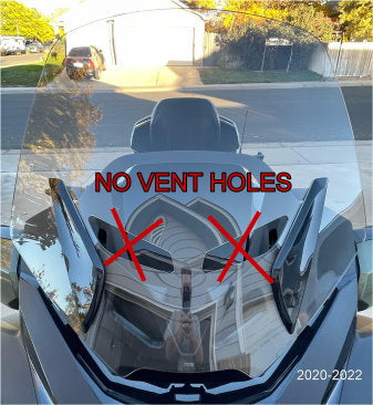

I would like to find a recurve, like the Long Ride Shield on my Harley. The curve at the top of the windshield seems to really help with pushing the wind up over my head, but LRS does not make one for the Spyder.
Look at member Quickdraws ad in "FOR SALE BY OWNER" forum. He has a 20" Freedom recurve shield for sale. Also, check out a 7Jurock shield. They can also cut out the vent holes.
