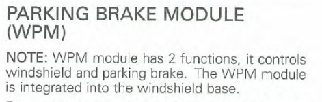

I checked the fuse with a meter. It's ok. I did not see a relay in the on line diagram. There is a "WPM" windshield parking break module, but I think is part of the windshield motor assemble.
F3 supplies power to a lot of stuff through R3. There would be a lot going on if either one was bad. The parking brake and windshield motor don't have much else in common except the module. The windshield switch communicates with the module via the CAN Bus, but the Parking Brake switch does not. Not much you can do except check the connector or do some continuity checks. Otherwise, it calls for replacing the module. Which is the first I've ever heard of one going bad. Check the connector first.
