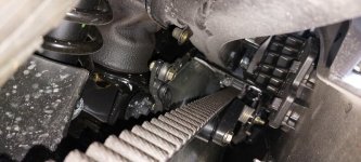

Dealers have frequently not connected the small link that goes between the swing arm and the level sensor that tells the air system to add or release air from the air bag. A friend bought a new 22 RTL from a dealer in Bonita Springs Florida about 3 weeks ago. I was aware of this common oversight so I took a picture of the link (not connected to the swing arm) and showed it to the salesman. He assured us that he would make sure that the service department connected this when they did the PDI the next day. Guess what???? The link did not get connected during the PDI and my friend didn't check it. I took another picture. The dealer sent a flatbed truck to pick up the Spyder for repair. A day later they delivered it back to my friend. STILL NOT COMMECTED! I sent the picture to the service adviser and explained what the link was for. They sent a senior tech to my friends house and he finally connected the little link. I think its a 10MM bolt. He explained that they use very junior (cheap) techs to uncrate and assemble new machines. I suggested that maybe a senior tech should check the junior tech's work. The attached picture is upside down and I can't fix it.
