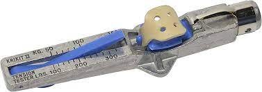

I just grabbed a photo of a Krikit. 160 is what you want in the measurement range, different sizes available. Pick the one that suits. . Poly ribbed size seems to be the one. There is a video I put up in an earlier post on how to use it. A good bit of kit for anyone with a Spyder - essential tool I reckon.

I picked up this one. Krikit 91132.
Description
GATES KRIKIT II V Belt Tensioner Gauge
Designed for tensioning V-ribbed belts on passenger cars, light trucks, heavy trucks and buses.
Bright green pressure pad and indicator arm
Calibrated to measure tension from 100 to 320lbs and 50 to 150kg
Measure belts up to eight ribs in width

If you are in the market for one shop around. 1 supplier wanted 6 x the price I got my one for.
