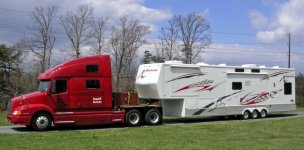

Our toy hauler was advertised as being 16,000 lbs from the factory. When we weighed it loaded with our stuff (we were living in it at the time) it came in at 23,000 lbs! That explained why the big dually pickup struggled so much and I was always on edge while towing.
We replaced the pickup with this and loved it:
